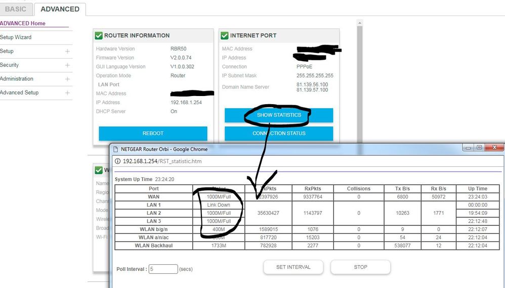

- martyfpSep 28, 2017Luminary
Link speeds are shown in the "Show Statistics" pop-up.... when I had a cable problem on one device I could see it's rate drop to 100M
- madbrainSep 28, 2017Luminary
Thanks , Marty , good to know !
The stats seem to be there only for the main router though, no stats for the satellite LAN ports as far as I could find.
And no link speeds for Wireless clients, either. At least we now have the wireless bands for each one.
yes, good point. That would be useful
- eemattSep 29, 2017AspirantThanks Marty! Even though it only shows the router ports it helps a lot! Thanks again
