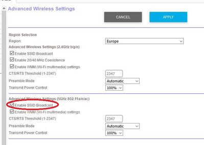

Thanks, michaelkenward Netgear support wasn't helpful when I asked how to disable the 5ghz band. I found references ibn the community saying it could be done via the command line, but didn't find directions. I also couldn't find a way to use different passwords or SSIDs for each band.

Aredub wrote:
Thanks, michaelkenward Netgear support wasn't helpful when I asked how to disable the 5ghz band. I found references ibn the community saying it could be done via the command line, but didn't find directions. I also couldn't find a way to use different passwords or SSIDs for each band.The idea is not to disable 5 GHz but to stop the SSID from being broadcast. In that way, wifi clients used to set up IoT devices will not see the 5 GHz wifi and will connect to at 2.4 GHz. (You may have to tell the wifi client to forget that it knew the 5 GHz SSID or it can connect even if it cannot see it.)
There is nothing tricky about doing that. No telnet or command line moves. It is simply a case of temporarily switching it off the 5 GHz SSID in the browser graphical user interface.
People have also had success by turning down the power from the 5 GHz wifi on the basis that their wifi clients will then prefer the 2.4 GHz band.
This is all very straightforward and has bailed out many people who are grappling with poorly designed IoT set up software. Only purists and propeller heads insist on separating 2.4 GHz and 5 GHz, even though it actually breaks the fundamental design mesh concept of Orbi systems.
