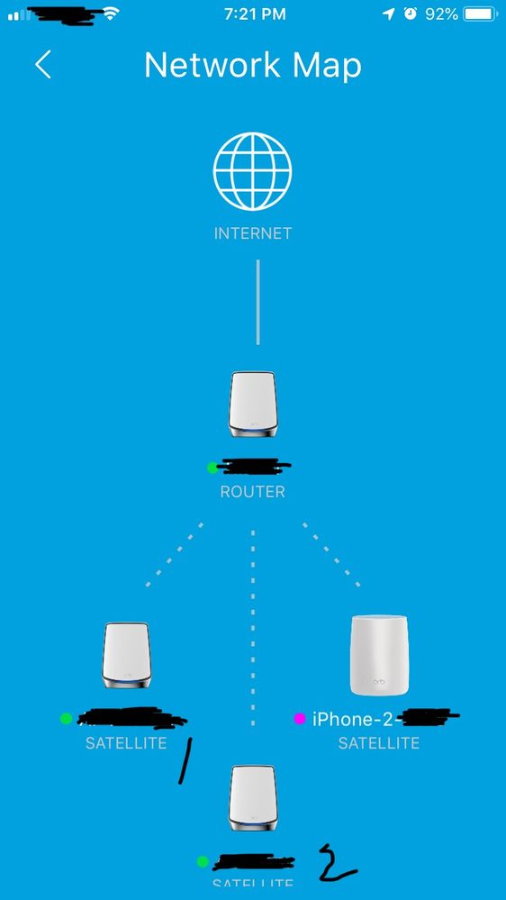

IPhone showing as satellite on Orbi app
Why, after 4 miserable months with the pos RBK750S system, does my wife’s iPhone 7 suddenly show up as a satellite on the Network Map of the Orbi app? I am not aware of any setting changes to the net...

The issue isn't the name. The iPhone is showing up as a satellite on the Network Map of the app. I have 2 satellites. The network map shows three with one being my wife's iphone (under the name of iPhone-2).

I appreciate you trying to help me out, and I apologize for my limited knowledge. I triked what you suggested, but all of the editable options (connection type, device type, IP address, MAC address, connected route, link rate) are appropriate.
The 2 satellites and the iphone 7 are in a star configuration. The map shows the iphone 7 leading to the router, although it is actually connected to satellite 1. All devices and the network are functioning normally as far as I can tell. Therefore, this may just be a minor annoyance.
I have the Orbi app loaded on an iphone 6 and a newer ipad. They both show the same thing.
The Network Map does not change after turning off and on the iphone 7/"satellite" and both devices which have the orbi app.

I tried to add an image. It showed up on my screen but did not show on the site after I hit send. Trying again.
That looks like something else. A more serious issue with the setup.
Have you been through the "reset" palaver?
What does that iPhone look like in "Devices"?

By the way, after power cycling the system, the Network Map changed. It still shows three satellites with one being the iPhone, but the phone is now at the bottom center of the map with a short solid line above the icon with the line not extending up to the router. The true satellites have a dotted line extending all the way to the router.

What a bizzare situation. It might be worth a few minutes to look at the Orbi web interface (http://orbilogin.net) to see if it also thinks the iPhone is an Orbi satellite. I can think of no scenario which would result in this crazy display.
The dreaded "Factory Reset" is indeed considered the last resort when solving Orbi problems. In my case, it can take over two hours of drudgery to set up all my IP assignments, devices names & types, DDNS, OpenVPN, etc. etc. On the other hand, an Orbi that has been customized only to the extent of changing the WiFi name/password and the web password can be "back in business" in under 15 minutes. If the Orbi internal tables are so mangled that it reports an iPhone as a satellite, only a "clean sweep" has a chance of dealing with it. Only you can decide if the potential benefit of having the Orbi app display be correct is worth the effort.
