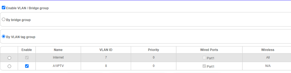

Thank you very much for the information. I did just read the article. I tried to follow the instructions as best I could but when I add the profile for the IPTV, I lose all internet. When I unchecked "Enable VLAN/Bridge Group" I get my internet back. What am I doing wrong?

One other thing. I am not getting my IPTV from my ISP so do I not need to do what the article said?
- schumakuMay 14, 2023Guru - Experienced User
....so very unlikely you resp. this A1xIPTV are using an IGMP Multicast based transport coming over a VLAN direct from your internet ISP. So the answer is yes, you don't have to take care about the article referred.
To round this up, your computer or App installed on whatever IPTV-box does very likely use singlecast.
