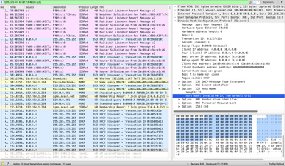

Some small progress... I connected my laptop to the wired LAN port of the router and ran Wireshark. I noticed that after a few minutes the router started *sending* DHCP diiscover messages where the "Host Name" option 12 was set to "Invalid HW ID, use default Orbi"
This seems pretty strange to me? (maybe it's checking for another DHCP server on the same subnet... but that hostname is disturbing!)
So - I put my wired ethernet config back to DHCP and, for the first time in ages I got assigned a DHCP address ... on a 192.168.1.0/24 subnet iwth a router of 192.168.1.250 (not an IP address I've ever used!)

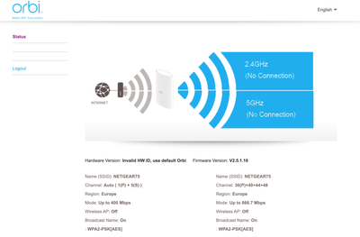

So.. I tried hitting that with a web browser. Got a login prompt. Tried the default netgear credentials of admin/password and got a very broken looking management page:Note the bogus hardware version string matching the DHCP messages! Also, the configured SSID is NETGEAR75 and the wireless access point is Off.
I poked around some of the missing menu options and found there was actually an invisible link to a firmware update page (http://192.168.1.250/fwUpdate.htm) .... again with missing button images/text.
Guessed which was the 'choose filename' box and got a file selection dialog.Selected a firmware image from my laptop, clicked what looked like 'Upload this' and got a "Please wait a moment" popup and my status bar showed "Upliading (15%)"
Then after a while I got the following error:404 Not Found
This server does not support the operation requested by your client.
and my web browser address bar showed: http://192.168.1.250/upgrade_check.cgi?/fwUpdateCheck.htm%20timestamp=81087512679
SOOOO CLOSE!Looks like it's trying to validate the image in some way and I don't know how to bypass that.
