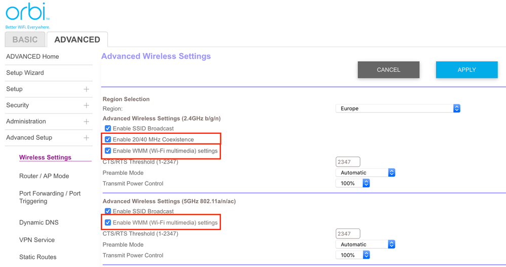

One last thing to test! Packet drops can also be caused by the fragmentation thresholds. Default CTS/RTS Threshold is 2347 for both 2.4 and 5 GHz bands. Please try to change those something lower, start with 2307 and then try different values between this figure and 2347.

Regarding your cameras:
1. Are they using the 2.4 or 5 GHz bands?
2. Have you tried to make a wifi scan and select channels that are not or least used by others?
3. How far are the cameras from the router/satellite(s)? Does it make a difference if you get them closer?
4. Have you also thought that this issue can be caused by the device you are streaming on, does it have a good connection to Orbi?
5. Is WMM enabled in the advanced wireless settings?

Is the performance of the camera better when it's on the 5 GHz than when on the 2.4 GHz? Or do you see issues with both bands?
Is the following setting enabled in Orbi?
1. 40/20 MHz coexistence which is useful if the camera does not support 40 MHz bandwidth on 2.4 GHz band
2. WMM which gives priority to audio and video packets over other packets.

I had played around with teh 20/40 coexist when I first picked up the ORBI. I didn't find any difference in performance but I've tweaked a lot of things so its worth trying again. Same with the 2.4 vs 5, both drop frames.
WWM is set on.
Daisychain is set to off. I bring this up because I think that Netgear had me turn this off when I first bought the ORBI and I thought I saw a post that it was OK to turn it back on again.
