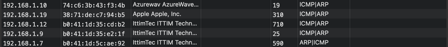

- JroachJan 15, 2019Luminary
attached are the top offenders. Not all of the cameras made the list but the ones that tend to be more active (motion or continuous feed). Without wiring the cameras, I think this is as good as it gets.
I'm goiung to dig into the cmaera settings a bit more to see if there are any tweaks that improve my situation.
