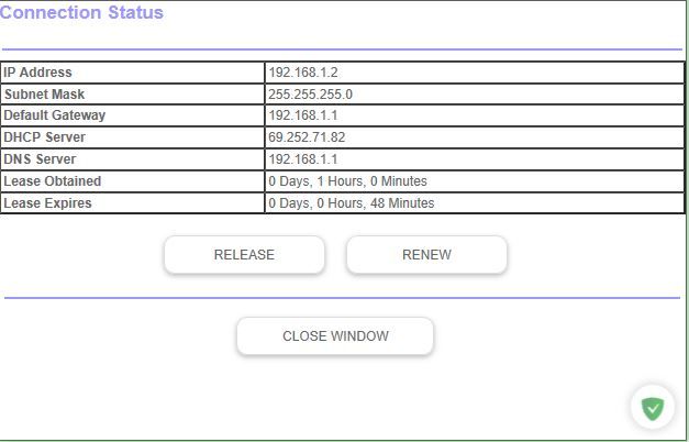

Can anyone running in AP mode tell me if on their on their main RBR50 "Advanced Home" tab if the value under "Lan Port" > DHCP is showing On or OFF?
- jdpg2Apr 06, 2018Apprentice
I believe i have found the issue. I appears that the DHCP Server value in the nvram is not being reset when switched to AP Mode. In my case it is set to a Comcast IP (something that was left over from the default router mode setup). The DHCP value should be set to the Default Gateway value (in my case 192.168.1.1). This is why the Orbi is not passing the IP address on to wireless clients. please see in the attached picture.
Anyoen else running AP mode care to confirm on their setup?
In AP mode it is set to get ip dynamically . My Router is configured to "serve" the same IP to the Orbi AP.
Could you do me a favor and look at what is listed under Advanced Home, in the Lan Port section , click on Connection Status and tell me if your "DHCP Server" value is the same as your "Default Gateway";?

Yes, my DHCP server is 10.0.0.1 and my default GW is 10.0.0.1. My Orbi IP in AP mode is set to 10.0.0.201. This is picked up via DHCP and is a static reservation in my Mikrotik router.
We have a winner!!!!!... there is a bug in the FW... thats the issue i am having the nvram value for DHCP Server is not being reset to my Default Gateway. ie the real DHCP ip address.
Well some Putty and the internet and i have it sorted out. There clearly is an issue somewhere in the new FW. But after some nvram show, grep, and set i over wrote the wrong DCHP values and i now have Wifi.
