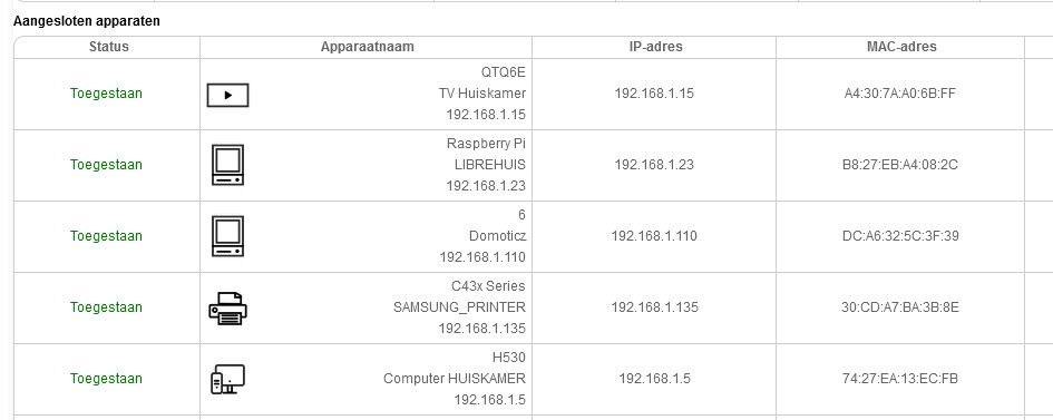

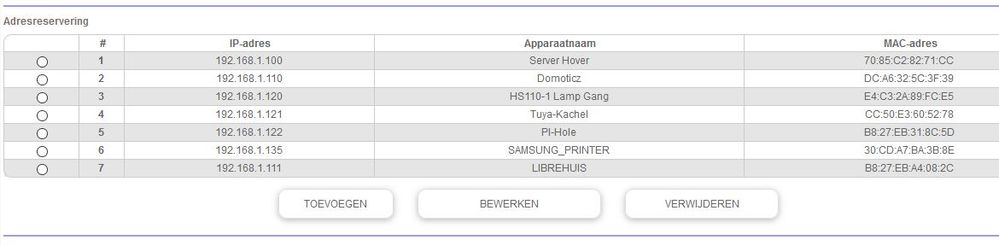

      Further to my message this afternoon. I am trying to change my sound system on address 23 to 111. I have tried everything but it does not change. In the list I show the situation: The reserved I list:
      And the list of connected equipment:
      I have tried everything: rebooting the router. Disconnecting en re-connecting the device. No luck the device stayes on adres 23. All the hairs in my head have gone, no new ideas!
