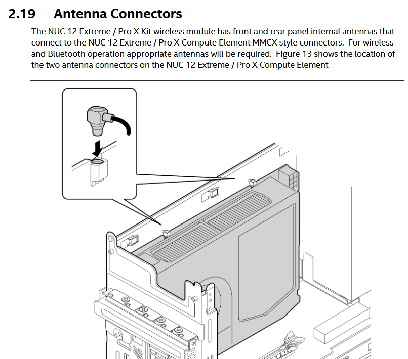

It might be helpful to understand the placement of the Google Pixel Pro and the PC in relationship to the Orbi WiFi. (how far?) Also, page 33 of the Intel documentation shows two antenna connectors. I get the impression that there are antennas built into the side panel of the case. WiFi antennas do not cope well with metal, so if they are on the "far side" of the computer from the Orbi router, that might affect WiFi performance.
