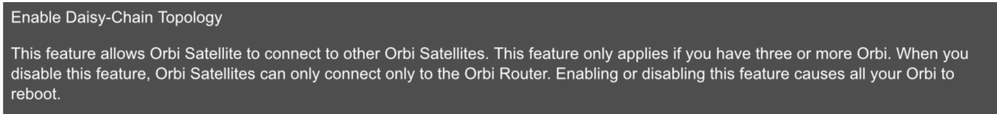

*** There are posts on this forum, answered by moderators, that claim you can only have 3 satellites for a router. (for example this ) According to the firmware, this is not true at least as far as chaining is concerned. This is a screen shot from the "help" in the administration console's "Advanced Wireless Settings" page. It says that the Orbi chaining feature requires 3 or more devices and does not specify a maximum.
