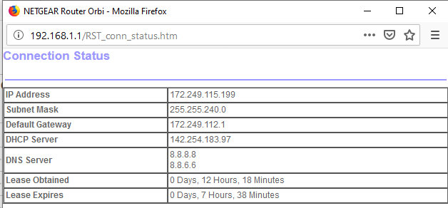

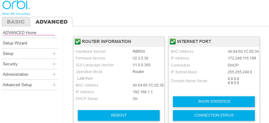

      Could you do a small favor and look at the router "DHCP Lease".  i.e. on the Orbi web interface, click on the Advanced Tab:
      And then clock on "Connection Status"
      What does your Orbi show for the Lease Obtained and Lease Expires?
      • pkdowning's avatar
        pkdowning
        Thanks for the response:
        It says
        Lease obtained: 1 hour
        Lease expires: 36 minutes
