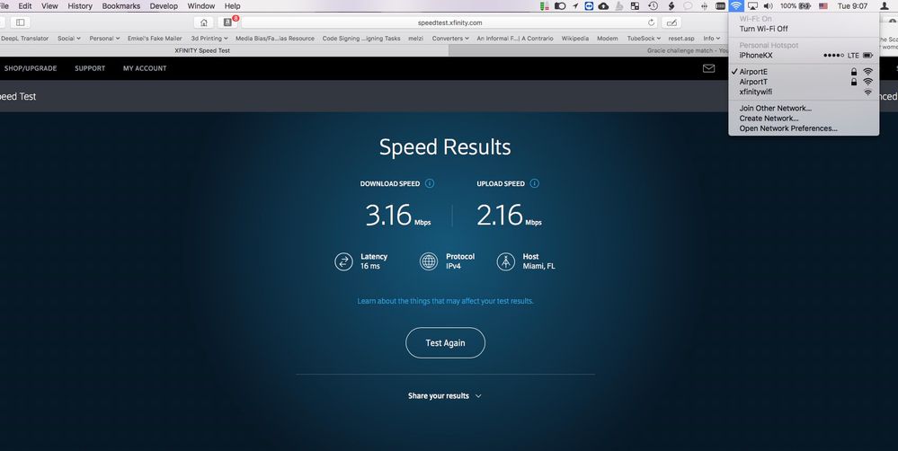

So I installed the Orbis (x2 - 5000ft^2) in my 3200 ft^2 home. Since that time I have very unrelaible conenctions. Below I have screen shots of a MacBookPro (802.11ac) at 4 meters from the main router with 1 interior wall separating. Note that these are within minutes of each other on a network which provides 126 Mpbs to the router wired. AirportE is the Orbi net.
