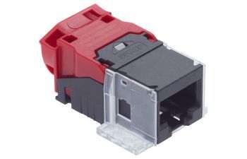

I'd tend to suggest strict wiring schemes only, avoiding these CP style cables.

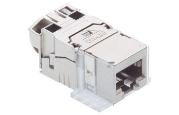

There are modern installation systems available in the market, in modern buildings, unshielded UTP CAT6A and CAT7 cables can be deployed trouble-free up to 10 GbE, and almost tool-less installable - just a sharp side cutter plier is all you need for unshielded as well as shielded cables:
If you plan more, link speeds beyond of 10GBASE-T, there are wonderful cable connector modules available from the industry, even for RJ45 connectors. For example, the R&Mfreenet Cat 8.1 shielded connection module, part of the freenet cabling system, are ideal for very fast data transmissions and high bandwidth applications. This high-performance Cat 8.1 module is perfect for use in 25/40 Gigabit Ethernet (25GBASE-T / 40GBASE-T) and future high-speed applications up to 2000 MHz.
Image source. rdm.com

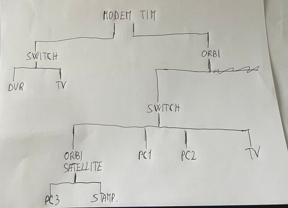

Is this other type of LAN network feasible with 2.5GB fiber in order to share the bandwidth?
- FURRYe38Sep 16, 2023Guru - Experienced User
Something to ask the ISP about. If there modem or ONT has a router, then the pictured configuration would be possible. If the Modem or ONT doesnt' have a built in router, then you can only have one or the other configuration. I presume your wanting the Orbi config. That works for the modem or ONT with out a built in router.
Contact the ISP to see what is going to be installed at your place and what can be connected.

- pierre22Sep 30, 2023AspirantI have to connect a TV and the DVR to a switch, which will be connected to the modem and to another switch I will connect three PCs and a printer as well as another TV, in this way can I create a high-performance LAN network?
- michaelkenwardSep 30, 2023Guru - Experienced User
pierre22 wrote:
I have to connect a TV and the DVR to a switch, which will be connected to the modem and to another switch I will connect three PCs and a printer as well as another TV, in this way can I create a high-performance LAN network?It depends on what goes on the link to the DVR. Your description suggested that it was the only thing on that link.
TVs are often 100 Mbps on the LAN.
Why not just try it before you spend any more money on wiring that might not be needed?
