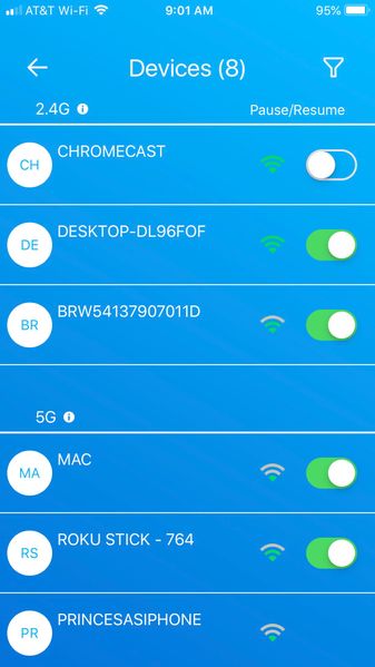

I can login to the Orbi app on my phone. It does disconnect intermittently.
I cannot login to the Orbi login online on my desktop (which is connected to wireless) or on an iPad which is connected to the Orbi's wireless. I see both devices on the Orbi app so I know they are connected to the Orbi. It makes me think something changed in the setup, like when the Spectrum tech went into our modem and resetup the wireless, even though she used the same name/password maybe that has caused me not be able to login into it online??
Would a factory reset maybe correct this? I have unplugged everything from both of them, rebooted the ISP modem and then plugged the Orbi and satellite back in. They IMMEDIATELY came back on and connected, work and send good signal... and then will fall out for a few minutes and come back.
You asked about the size of our home- 2 floors, each about 1200 feet. One Orbi upstairs, one down. For over a year the easy setup has worked fine. Never a problem.
