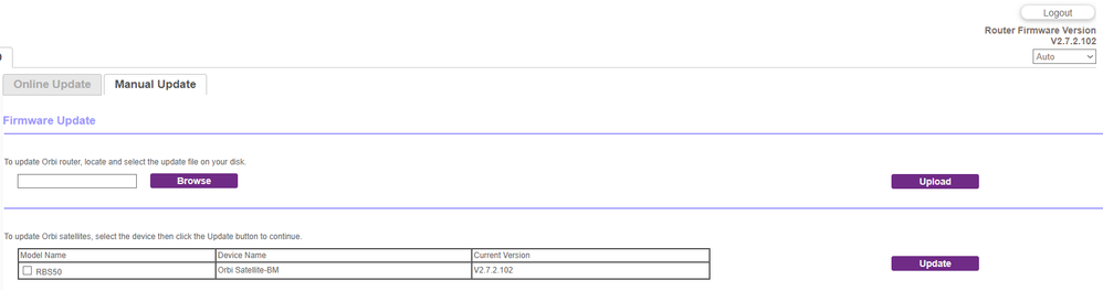

- FURRYe38Dec 28, 2020Guru - Experienced User
You can manually download FW files from NG support site:
https://www.netgear.com/support/
Then use the RBR or RBS web page to send the FW file using there web pages using a web browser:
KenJB wrote:Hi - Sorry to bother you again. Yesterday you wrote: "Firmware update can be done using a laptop that is connected over WiFi." Can you tell me how? My attempts to do this with the App gives me an annswer that my firmware is up to date which is not the case.
