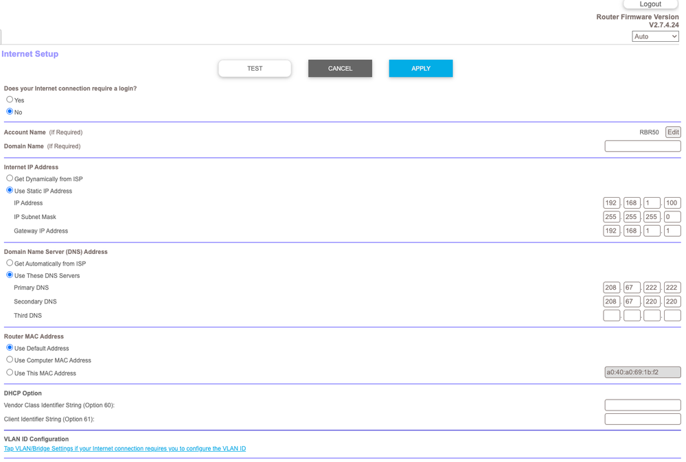

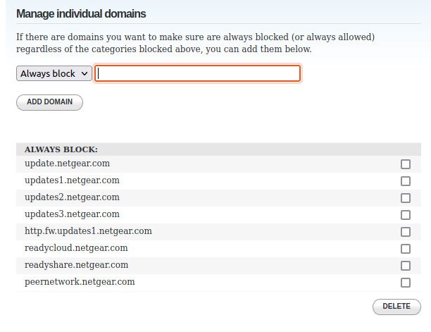

Need help to find a working solution to stop auto updating RBK50's firmware
Hello. I have a RBK50 kit with 1 router and 3 satelite. I got stuck with this systems after netgear release the newest firmware 2.7.4.24. The satelite alway loss connection with router. I tr...

Yes i did block these URL, sorry for use wrong word "ip address" .
Does the blocking via opendns solotion work with you ?
Please check my setup in opendns and in orbi setting. Did i setup right enough to disable auto update ?
