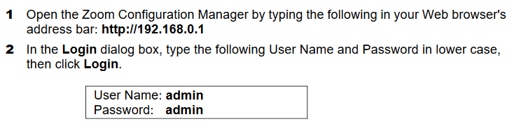

Here is a link to the user manual: http://www.zoomtel.com/documentation/cable/5363-UserManual-Eng.pdf
On page 30, it shows how to log into the modem:
I believe it is on page 95: "Primary network bridged".
There is also a menu for turning off the WiFi system
Good Luck!
