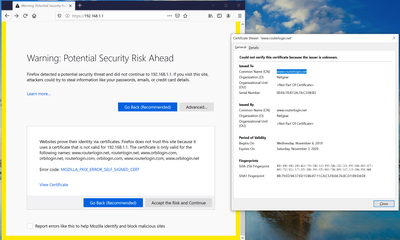

Thanks for sharing this (unexpected) news. Would it be convenient to post the actual certificate information?
Of my many browsers, Firefox seems to do the best job of actually showing the certificate information.
Here is how Firefox displays the certificate that expired in August:
- tomschmidtNov 26, 2019Virtuoso
Here is the certifcate error shown on Firefox 70.0.1 for the V2.3.5.34 firmware:
orbilogin.net uses an invalid security certificate.
The certificate is not trusted because it is self-signed.
Error code: MOZILLA_PKIX_ERROR_SELF_SIGNED_CERT
