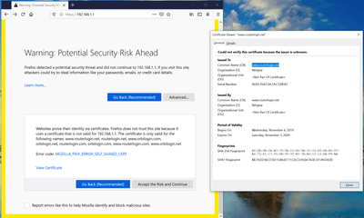

2. Web browsers still do not trust the updated https certificate for the .34 release. The expiration date of the certificate is now for November 2029, but Edge, Internet Explorer and Chrome browsers still do not trust the certificate.
CrimpOn
Nov 25, 2019Guru - Experienced User
Thanks for sharing this (unexpected) news. Would it be convenient to post the actual certificate information?
Of my many browsers, Firefox seems to do the best job of actually showing the certificate information.
Here is how Firefox displays the certificate that expired in August:
- tomschmidtNov 26, 2019Virtuoso
Here is the certifcate error shown on Firefox 70.0.1 for the V2.3.5.34 firmware:
orbilogin.net uses an invalid security certificate.
The certificate is not trusted because it is self-signed.
Error code: MOZILLA_PKIX_ERROR_SELF_SIGNED_CERT- Wire1852Nov 26, 2019Apprentice

tomschmidt wrote:Here is the certifcate error shown on Firefox 70.0.1 for the V2.3.5.34 firmware:
Error code: MOZILLA_PKIX_ERROR_SELF_SIGNED_CERT - FURRYe38Nov 26, 2019Guru - Experienced User
Did you clear out all browser caches in FF, exit the browser then restart it?
Does this happen with any other browsers?
I'm not seeing this with v40 loaded.
Error code: MOZILLA_PKIX_ERROR_SELF_SIGNED_CERT- tomschmidtNov 26, 2019VirtuosoBrowser cache clearing does not fix the self signed certificate error. Same error with IE, Edge, Chrome and Firefox browsers.
