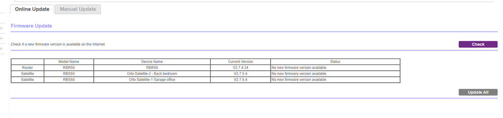

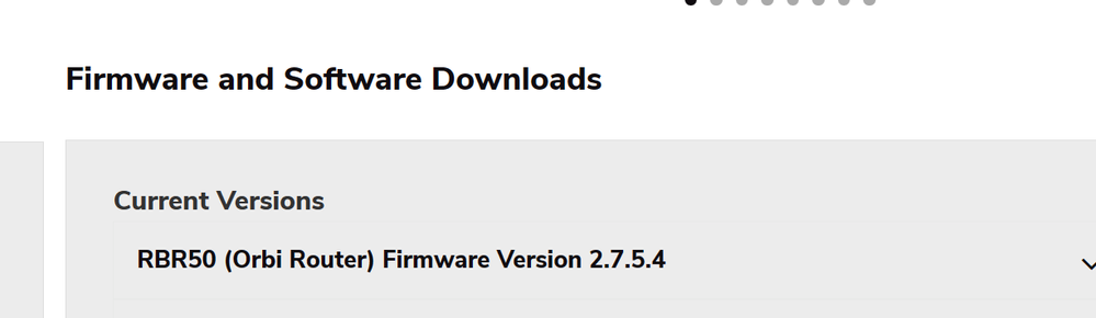

Mar 23, 2023Aspirant
FURRYe38 Thanks for the prompt - I tried again as before following the instructions by using the OrbiLogin and tethered directly to the RBR50 from my laptop using the compressed file on the Netgear site (Firmware Version 2.7.5.4) however was still only seeing the same screenshots as below:
My next attempt is to use the MS Edge browser and download a fresh file and try again, I am also using the Manual tab to force the upgrade however as the RBR50 is not shown on this tab it just isn't possible. I also updated the RBS50s without any issues and am concerned that I could have performance issues if the versions of FW are not aligned. Looking at some other advice a factory reset could be the last option, something I would prefer to avoid. Any helps or guidance is welcomed!
FURRYe38 , KevinLiT Just to add I did read the below on the instructions in the first post on this subject, however, it doesn't make sense if you give me access to the RBR & RBS FW update then only allow the RBSs to be updated and no checkbox or way to update the RBR....
NOTE: Orbi app or the routers web page may not report seeing new FW updates. NG may not push this to there auto update services immediately and may activate the newer FW update being seen on there auto update services at a later time. User will have the choice to manually update if you want too.

- SlychlanderMar 23, 2023Aspirant
FURRYe38 the RBR doesn't show as an option in the Manual tab, therefore I am unable to send the FW file that I unpacked from the .zip file?
The version seen on the RBR home page at the top is the old version v2.7.4.24
I have also just lost the RBR50 completely and restarted it and now its back on and green, however both RBS50s have disconnected and showing as red. I hope this isn't the fact the FW is not aligned.
- FURRYe38Mar 23, 2023Guru - Experienced User
So under the Manual Tab with in the FW update section, you don't see a Browse button here to open up a navigation window to navigate to where the unpacked FW file is on your PC? https://kb.netgear.com/31573/How-do-I-manually-upgrade-firmware-on-my-Orbi-router-using-orbilogin-com
