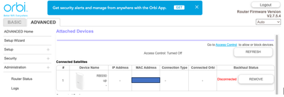

TLDR:
I'm having problems: My satellites have disconnected and won't reconnect.My router updated itself to 2.7.5.4 a few days back without my knowledge or involvement. Probably March 1.
That's when both my satellites disconnected and won't reconnect despite cold boot of the satellites, resync atempts by pressing the buttons or through the web interface. I even removed a satellite from the system and brought it into the same room as the router.. No dice. It tries, I get the solid magenta ring LED on the satellite.. sometimes it gets an amber ring for a few seconds.. then a solid magenta.I don't know if the satellites updated or not, as they are never accessible.
Questions:
Any advice on how to proceed?Are my satellites bricked?
PS: My devices all over the house disconnected. It takes a long time for them to reconnect for the first time, even when supplied with correct password. After that, they connect fine. They are all connected to the router now.
- alokeprasadMar 02, 2024Mentor
Follow-up:
I reset the satellite using the reset button at the back.
On resync attempt (using the buttons).the satellite ring light becomes solid blue (đ) but refreshing the "connected devices" on the router web interface shows no connected satellites (đĄ). After 30 seconds of this, the satellite ring light turns solid magenta.
So, it is trying something and failing. I am loath to reset my functioning router, in case I lose my whole home network..
