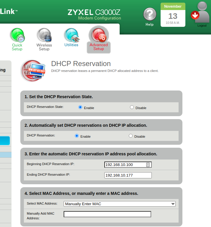

Thanks - I'll work on that over the weekend. Interesting, I looked at how my CL router is setup for reservations and it has an odd to me at least config:
Default as above has a whole bunch of devices with reservations that I don't care about.

Use the Choose File button at the bottom of the editor screen to inlcude your picture files.
- jhoff909Nov 13, 2020Apprentice
That's strange, let me try again:
But trying to do it in-line:
Interesting, inline doesn't seem to work.
- FURRYe38Nov 13, 2020Guru - Experienced User
I see the IP address range and DHCP state and reservation sections....
The inline picture has to be approved by a forum moderator. :smileywink:
If it's not obvious, the config creates an automatic reservation range where if a client gets an IP address in that range (in this case from 100-177) it automatically gets a reservation. I didn't show it but below, I can see a large number of reservations, some from devices that transiently visited (friends phones, etc). I have the DHCP range (a different page) set to .100 - .254 and have clients with static IPs configured in the 2-99 range. My RBR50 for example has one of the automatic reservations (.109) which is why it's IP address hasn't changed as I upgraded firmware, rebooted, etc. Which I was kinda curious about. I'm gonna turn that off, remove all of the reservations (none of which I care about) and setup a static IP for the RBR and maybe the two RBSs. Or realistically, just

using reservations is actually better... - FURRYe38Nov 13, 2020Guru - Experienced User
Can those reservations be removed from the modems UI?
Yes, there is a remove button. I have been avoiding touching it until later as if I start, I will get distracted and it's still a work (from home) day for me. But I would want to also turn off the automatic reservations featuer (2nd radio button in the screenshot) at the same time otherwise I assume they will just come back.
