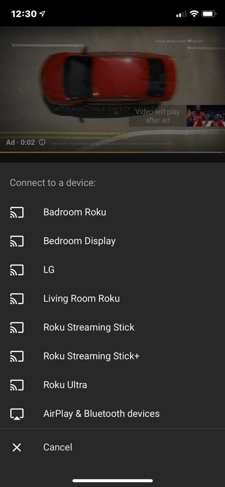

"[Bug Fix] Fixes the guest isolation issue for multicast and broadcast traffic between the main host and guest."
I was thinking that this fixed it so that guest can not stream multicast to the main host.
Allow guests to see each other and access my local network Guest Wireless Network Name (SSID) : "Allow guests to see each other and access my local network Guest Wireless Network Name (SSID) :"
This is frustrating and confusing at one time. On the last patch when I had this off it did not show any of the devices on my local host to the guest host now when I turn this thing on or off it still shows all of my devices on the guest network. Now when my brother comes over or the kids they’re always asking which device to stream everything to because there’s a whole list of multi cast devices on the guest network that it shows. I thought this thing fixed it where isolated the guest network. Apparently they’re pushing us into buying a Orbi pro version?!

Ok, I will ask! Hello, moderators! Why is it that guest clients don't seem to be separated totally from the main network, and in fact can access many resources on the main network? I do not like my guest to streaming to my TVs at 3AM and if I do not turn on "Allow guests to see each other and access my local network" then they can not stream to the TVs at all in the house.
I would like it in my house that guests can see each other and stay off the main network TVs!
