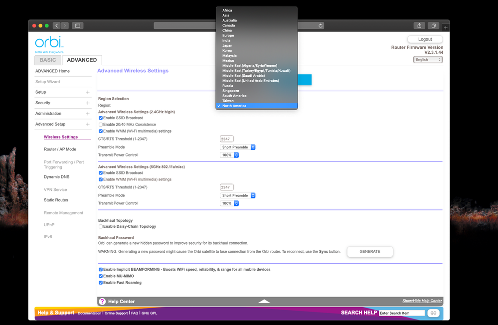

- SW_Apr 12, 2019Prodigy
If your setup is already configured properly, you don't need to change any setting. Here is a picture of my wireless settings. This works well for my setup, but it might not work well for yours. If you are curious, try it out and draw your own conclusion.
