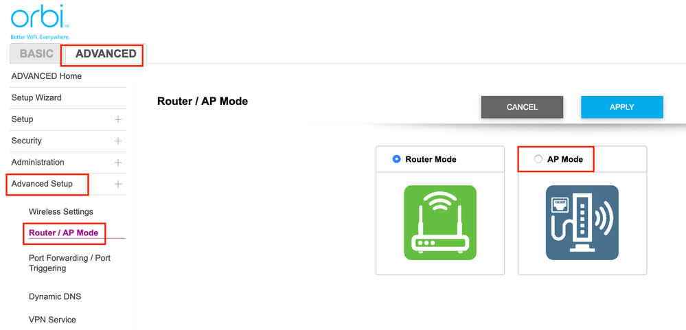

- ekhalilFeb 24, 2019Master
Timmeh1 wrote:
.......... So i think i need to bridge the two somehow.. Im going to try and log into my modem and see if I can do that or turn that option off on the modem.
Your modem can work in bridged mode as shown here. But it seems a bit complicated since then you need to configure the PPPoE and DSL credentials in Orbi.
I think your best option would be to keep the ISP modem as your router and set Orbi in AP Mode as follows:
