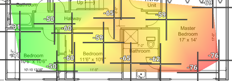

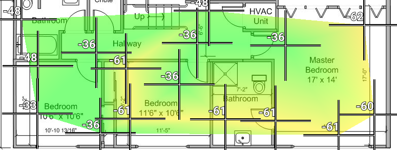

On this point, my empirical evidence appears to differ.  Having a spare RBR50 for testing, I set the Transmit Power to 25% and used a Heat Map app to make a quick study of the upstairs.  (Downstairs would be significantly worse.)
This is the heat map of the 5G Fronthaul channel:
This is the heat map of the 5G Backhaul channel:
Notice how the 5G user channel has dropped to -76dB at the far end of the house, whereas the 5G backhaul channel has dropped only to -60dB.
I can jack up the Transmit Power to 100% and make another heat map, but I set this test Orbi to 25% so it would have less interference with the primary WiFi system.
