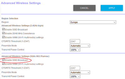

Nov 10, 2019Guru - Experienced User
jzryk8 wrote:
Hi, quick question, How do I turn off 5 GHz SSID broadcast.
Good question. We need step by step details for that for future reference.
- Login to Orbi graphical user interface (GUI)
- Advanced
- Advanced Setup
- Wireless Settings
- Look for Advanced Wireless Settings (5GHz 802.11a/n/ac)
- Uncheck Enable SSID Broadcast
Do your thing and go back and reverse the process.
Be sure to disble the wifi radio on your mobile device before you start to turn OFF the 5G SSID broadcast on the RBR. Then turn it back ON after the 5G has been disabled. This ensures the mobile device has disconnected fully from the 5G and re-connects to the 2.4G broadcast.
michaelkenward wrote:
jzryk8 wrote:Hi, quick question, How do I turn off 5 GHz SSID broadcast.
- Advanced
- Advanced Setup
- Wireless Settings

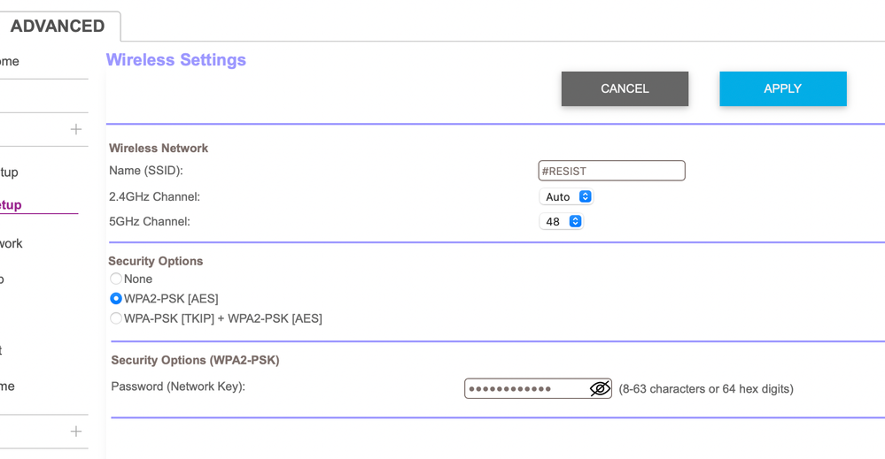

- DannySKAug 06, 2022Tutor
My Advanced Wireless Settings do not show buttons for specific channels. RBR50 v2.7.4.24
