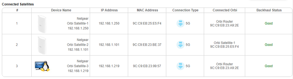

Hello, I'm hoping someone can help. I'm using the BT router with WIFI disabled, the Orbi mesh replaces the WFI and simply passes DHCP etc to the BT router (AP Mode). When logged into the RBR ...

I have terminated both the RBR and wired RBS into the same switch, the Netgear one which I have to assume ticks all the right boxes. The Syslink remains in the onward connecton to the RBS at the moment but before I unplug that temporarily to test further I noticed that this new configuration shows something unseen previously in the RBR admin panal:
The wired RBS (Satellite-3) is now reporting it is a Linux device and not an actual Orbi device. Does this shed any light on things, as it still thinks it is a 5G connection but I wonder if this Linux logo has been seen before and perhaps narrows down my search?
