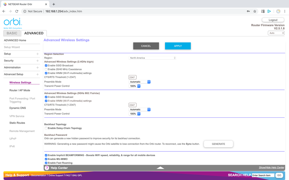

Here is an example of my current Wireless Settings, which seem to be working well with v2.5.1.8. Might want to download NetSpot to check out WiFi channels congestion. I found that "Auto" works best with 2.4GHz and pick an unused or least congested 5GHz channel. Good luck!
