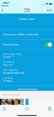

Orbi and Ambient Weather 2902 - Not able to report weather to Internet
I have an Orbi router and an Ambient Weather 2902 station. The Weather Station connects to the Orbi without issue and I can see that it is connected using the Orbi app. However, the Weather St...
- Aug 22, 2021Thanks for the input. This started working. I’m not sure what changed though. For those who have had issues with 2.4Ghz vs. 5Ghz this is working fine now on a mesh satellite node broadcasting both frequencies which is what I would have expected.

Trmmcd wrote:
I have an Orbi router and an Ambient Weather 2902 station. The Weather Station connects to the Orbi without issue and I can see that it is connected using the Orbi app. However, the Weather Station is unable to report its weather to the internet. I have tried all of the Ambient resolution steps including rebooting the router and have verified Mac Addresses etc. Is there a setting on the router that needs to be changed to allow this device to report to the internet (Internet access is turned on) If so, I can't see where that might need to be changed.
