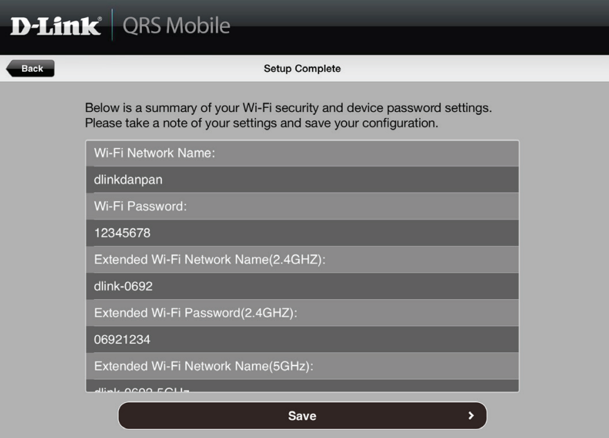

It depends on your extender. In most modern extenders you should be able to set the extended network SSID. I have two extenders at home from D-Link (2 different models, one of them is DAP-1620) where you can choose either to keep the same SSID or extend with the same SSID. You can also set different SSID's for the 2.4 and 5 GHz networks. Please see below from the setup wizard in the extender's app:

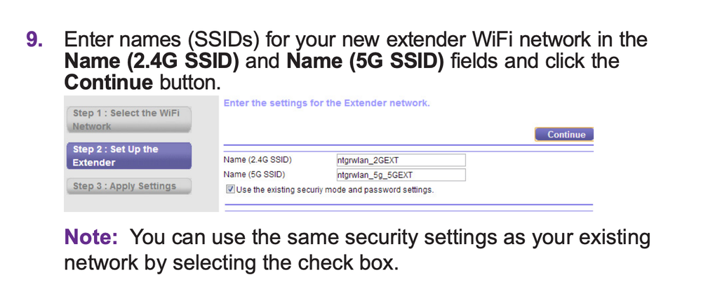

I checked your extender Netgear EX6100 and it has the same possibility. Please check the manual on: https://www.downloads.netgear.com/files/GDC/EX6100/EX6100_IG_27Nov2013.pdf
