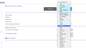

Orbi Blocking Websites - Solved
ORBI is blocking HTTPS websites that are not explicitly defined in URL.
To unblock any https website, do the following:
Log into to your router admin console (https://orbilogin.net)
Cli...

First, thank you for the original post. The quick start guide that came with my router said I am supposed to go to orbilogin.com, not net, so I could not get in until I figured out the IP address.
I followed the instructions and whitelisted HTTPS, but I am still being told that sites like Facebook are insecure. I also have services blocking set to never.
I have the Orbi connected via LAN to my AT&T Arris BGW210-700 gateway. The gateway is set to Passthrough mode with DHCPS fixed to the Orbi's MAC address. My computer is connected to the Orbi via LAN. I just installed the Orbi yesterday, and that is when I started having problems with sites being blocked. I have also had some apps on my phone blocked. I am assuming the issue has to be in the Orbi, because none of these problems happened before. Thanks!
