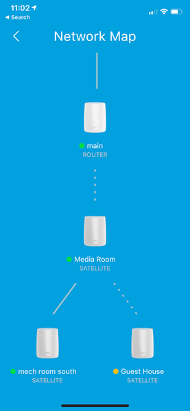

I have the Orbi router and two satellites running wired into a TP link switch. But the satellites connect to the router over the wireless backhaul. The satellites use the wired connection to connec...
- Jun 12, 2021
ArthurP wrote:I have the Orbi router and two satellites running wired into a TP link switch. But the satellites connect to the router over the wireless backhaul. The satellites use the wired connection to connect to each other but not the router! The third satellite is only wireless, as it should be.
My intuition is that the wired connection would always be preferred because it is more reliable, higher bandwidth and faster(?). Is something wrong here or is this normal behavior?

- Which specific TP-Link switch is being used?
- Orbi routers expect satellites to appear on LAN ports, not on the WAN port, so it is important that the switch is connected to an Orbi LAN port ('behind' the Orbi) rather than between the Orbi and the ISP modem.

Thanks. I'm using the TP-Link TL-SG1016PE 16 port POE router. I have not done any management, just plug and go. I have moved the satellite cables from the swtich to the router but I had to leave before I could check the status. I'll report what I find when I go back

Connecting the satellites to the Orbi itself rather than the switch did the trick Thanks!
