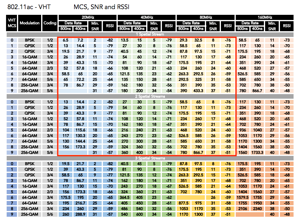

And, what is the speed, really, i should expect from both wirelessly or wiredly, locally.
- ekhalilDec 29, 2018Master
Ideally you should expect speeds close to the following (for transmissions between devices) in Orbi depending on the radio conditions and the number of spatial streams (antennas) in the devices (look in the red box below as Orbi has only 2 spatial streams and up to 80 MHz wide channels):
Internet speed is dependent on the your ISP among other things and is usually much less.

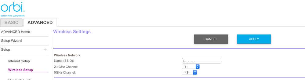

- Please make a wifi scan while your are in the vicinity of the satellite where you see bad wireless performance:
- See that the satellite is broadcasting 2.4 and 5 GHz band networks.
- Are there other networks using the same channels as the ones broadcasted by the satellite and note the relative power of those.
- Based on the result of your scan, please select the 2.4 and 5 GHz channels that are not or least used in your environment. Please set those channels in Orbi as follows:
