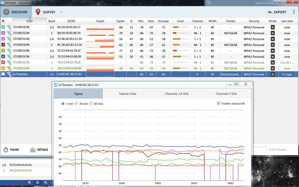

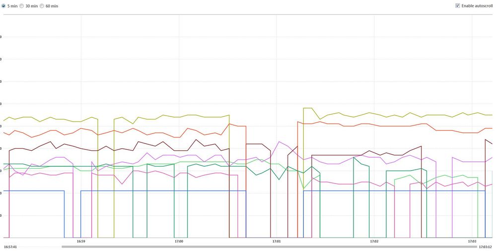

First picture show all wifi network in the house and nearby. Other sending wifi is Netgear arlo pro 2 with 9 cameras, in this picture they both uses channel 1, but i have the same problem when they are on different channels. The second pictures shows the drops from rotuer and three satellites. I also have lot of Philips hue lights and the hue hub is about 5 feet from the router and i also have lot of zwave plus devices and the samsung smartthings v2 hub is also about 5 feet from the router. Could it be one of those that makes/interferes the wifi to drop?
- jsturessMay 03, 2019Apprentice
I turned off the netgear arlo, philips hue and the smartthings hub. but it didnt help, still dropping wifi
