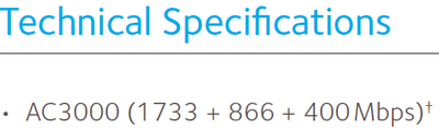

With ac, the maximum theoretical bandwidth of a 5G WiFi connection is 866mbs (the middle number of the "Marketing Speak" on page 4 of the Product Data Sheet:https://www.netgear.com/images/datasheet/orbi/RBR50.pdf
Contrast that with the theoretical 5G connection rate of 2400Mbps for the RBR850 product, which is a WiFi6 802.11ax based design.
The ISP router is obviously a newer ax product, which the newer iPhone can take advantage of.
The original question of satellite speed being lower than router speed may be a case of distance between them and building materials in the radio pathway between router and satellite. A simple (but better done when the family is not around) test would be to temporarily use an Ethernet cable to connect router to satellite. A 100ft Ethernet cable can be found on Amazon for under $20. Snake the cable through the house to switch the satellite from WiFi link to 'wired' link.
