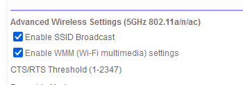

Hi, I want my router to work only on 2.4GHz. In Advanced Wireless Settings 5GHz I have the following settings: Enable SSID Broadcast = Unchecked Enable WWM = unchecked CTS/RTS Threshold (1-2347...

- The original Orbi 802.11ac product line, which includes the RBR20, has an option to not broadcast the 5G SSID. This is found on the Orbi web interface, Advanced Tab, Advanced Settings, WiFi Settings:
Uncheck this box. Click "Apply" at the top of the screen. The Orbi WiFi will restart. On the smartphone, "Forget" the Orbi WiFi. Search for WiFi again and connect to the Orbi. This will be at 2.4G because the phone will not see a 5G WiFi signal that it recognizes. Perform the setup. After everything is working, go back to check the box and "Apply."
