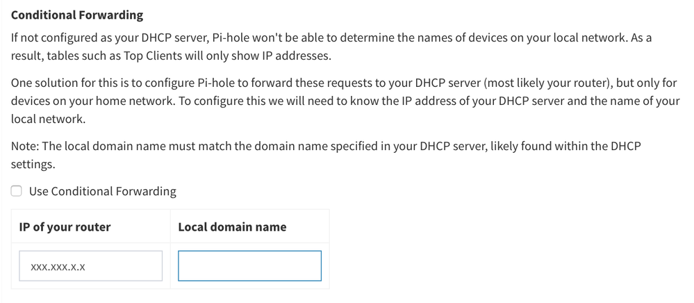

I'm just doing a basic setup, and want to turn on the "Conditional Forwarding" which requires the "IP of your router" and "Local Domain Name"

- feignitJun 11, 2020Star
I still don't quite understand the solution to this. What would I put in this form?
