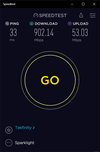

Just took a speed test with my RBR50 loaded with v2.5.1.16:
jhoff909 wrote:Newest firmware seems to help (2.1.5.16) but I'm still not getting gigabit speeds in both directions wired directly to the Orbi router. Generally get 700/200 or so.
