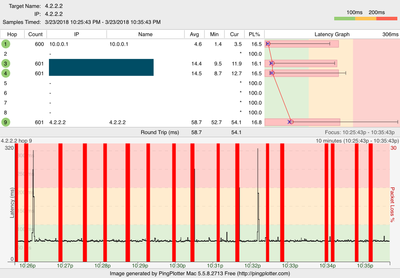

So I gave this beta a test run and disappointingly the packet loss issues are still there. As you can see from the graph, the communication hangs at regular intervals. This is a 10 minute graph with a massive 16.8% PL. For this test I tried several configuration combinations, factory reset and disconecting all devices from the network in order to isolate the issue to the Orbi devices. I have been doing this for each firmware version since 2.0.0.74
This issue began wirh firmware V2.0.1.4 with only a mild PL issue. Newer firmwares have been just as bad as the current beta. Fortunately I don't need Circle or ethernet backhaul so I'm goinga back to V2.0.0.74 for the time being.

PyroDog wrote:So I gave this beta a test run and disappointingly the packet loss issues are still there. As you can see from the graph, the communication hangs at regular intervals. This is a 10 minute graph with a massive 16.8% PL. For this test I tried several configuration combinations, factory reset and disconecting all devices from the network in order to isolate the issue to the Orbi devices. I have been doing this for each firmware version since 2.0.0.74

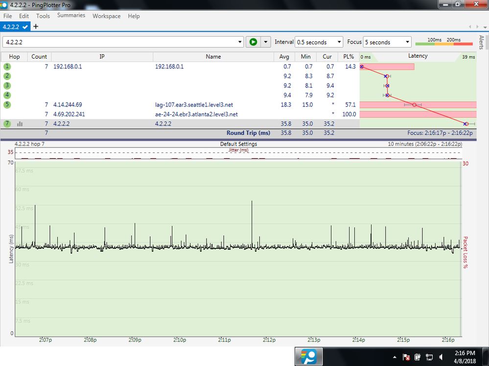

Ok, here is a rough 1st test. Not quite idea test configuration. Just a laptop connected wired thru two switches.
