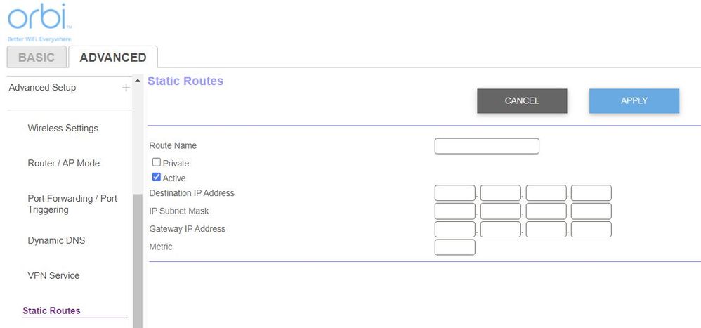

Going back to this, it looks like the RBR50 does not support the setting up of a range, does it?
- CrimpOnMar 14, 2022Guru - Experienced UserOn the web interface, LAN setup menu
