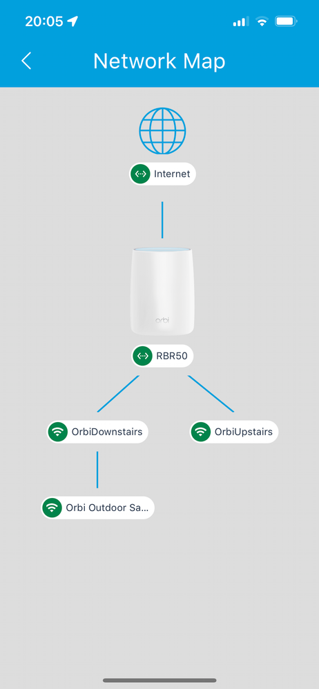

Orbi Outdoor connection issues
I have an orbi outdoor, the router is in the other end of the house and the kitchen is closest to the outdoor has a satellite. A while ago i had an issue where the outdoor orbi connected to the r...

Try lowering the transmit power on the RBR as well. Should help here.
Might consider updating FW on the inside RBS first, then RBR lastly as well:

Have tried powering off.. multiple scenarios to be honest. But I'll power down the RBR and see if that works. Thanks!
- PmonJul 19, 2023Aspirant
Hey thanks for your help, it seems that lowering the power on the Router made the outdoor orbi switch to the satellite so now I have it working all good. So thanks a mil and fair play to you I really appreciate the time you took to help me out.
