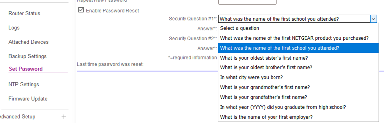

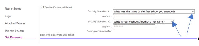

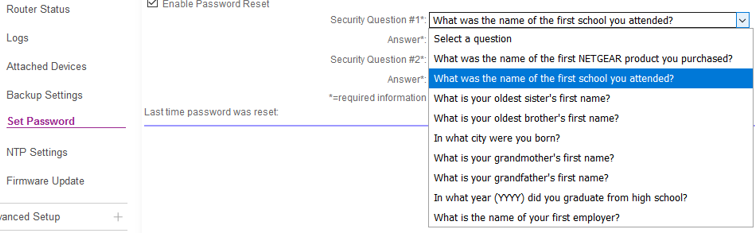

        Sorry I was not clear.  During the setup, users are asked to set an Orbi admin password (to replace "password") and have the option of selecting two Password Recovery questions.  They can choose to do this again by going to Password Reset from the Advanced Tab.  Here's what it the page looks like:
        Notice the "down arrows" marked with blue arrows.
        Click on the top arrow, and it brings up:
        Click on the bottom one and get this:
        This is what I mean by the web page being confusing.  If people do not realize during the setup that they have to actually pull the menu down, select a question, and then fill in the answer..... then when they come back the Password Recovery doesn't work.
