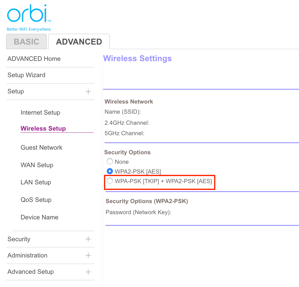

  • swifteee wrote:
    ..........  I ended up having to create a guest network with NO PASSWORD and ..........
    This can be a reason why it did not work, it can be that the device does not support the default WPA2 security. You can try with WPA instead, please see below:
