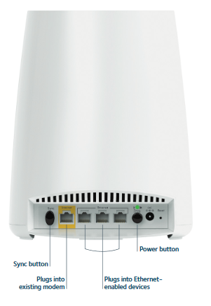

Can’t figure out how to hardwire to router to even login.Is this still an issue? What this means is connect an ethernet cable between a computer (PC or Mac) and one of the three "Plugs into ethernet devices" ports. Since the router is not functioning correctly, it is impossible to login. That is the reason for resorting to the TFTP firmware load in the first place.
