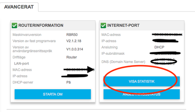

- atiq332Jan 23, 2018Star
How do i cheked my orbi connected time? because my orbi keep display CONNECTED sign on my wifi devices, every 3 to 4 min messaage on my mobile devices shows CONNECTED ORBI 120 ?
- Christian_WJan 25, 2018Star
Go to orbilogin.com and after you have loged in go to "advanced" tab.
And there you will find this....
