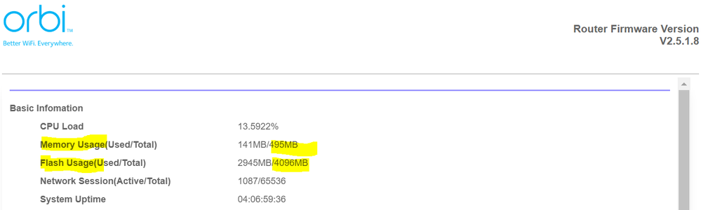

      I have the RBR50 v1 with the USB port.  Going to the http://orbilogin.com/debug.htm page shows that I have 512MB of memory and 4GB of Flash storage (round up from the 495MB number seen on the screen due to some memory reserved for the OS).  Below is a screenshot.  Can someone with an RBR50 v2 go to their debug.htm page and capture the same data?  It seems odd to me that the v2 would have significantly less Flash memory for storage (512MB) than the v1 (4096MB).

        Went to big box and bought RBK50 and I think it is v2 because the USB 2.0 port is NOT present.  Flash memory is definitely NOT 4GB!
        Spoiler
        Basic Infomation
         CPU Load46.283%
         Memory Usage(Used/Total)188MB/484MB
         Flash Usage(Used/Total)268MB/512MB
         Network Session(Active/Total)1783/65536
