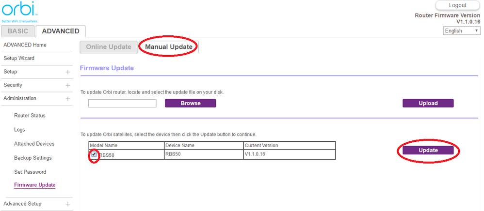

Bug Fixes: Fixes WPA2 KRACK vulnerability in Orbi RBK50 Home WiFi System
Visit the NETGEAR knowledgebase for more info and instructions on updating your Orbi RBK50 Home WiFi System to patch the WPA2 KRACK.

router updated no problem. but satellite will not take the update. it freezes on the initial upload and refreshes the screen to upload again.
- waynealightApprentice
power cycled system and it finally took
- bar_p_ranchAspirant
I have downloaded the patches and cannot get the satellite to update as I am getting prompted for a username/password before the update can be done. I've tried the username/password that I successfully used to get into the orbilogin.com page, but that does not work. I've hardwired to the router and tried to update the satellite, and get the password prompt that keeps failing. I've hardwired to the satellite, logged in successfully, set up to do the manual update and get the password prompt. I've tried the password that works to get into the orbilogin.com, and I have also tried 'password'. What am I missing? Do I need to try to update the router first (even though the instructions say to do the satellite first)?

No problem uppdate here.I did uppdate my two satellites FIRST (one at the time)and then update the router. I've successfully updated both now and its working.
