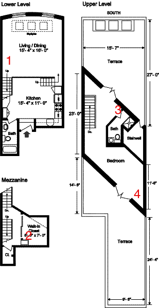

Thx, between coverage issues upstairs, and needing ethernet jacks for the NAS in the mezzanine area, I ended up with 3 satellites. One thing I didn't realize is that the 5G signals probably have a harder time penetrating the metal walls around the BR and that 2.4 would have been better.

I can't say for certain what happened, however something was redirecting https traffic to http and if it wasn't for it being common for websites to warn you of this now, I would not have noticed this. And this was happening from other computers on my network (mac and win) including one from work that's highly locked down. Also, the fact that I could no longer log into the orbi admin screens or use the ios app are pretty strong indications of the router being hacked.
I check for updates fairly frequently in either the IOS app or the web admin screen but haven't seen any in a while. These are the versions post this incident. I don't recall if I forced an update or not when I did the hard reset. But I do use the Orbi app to check for updates often and always have. Maybe the update function itself is not that reliable? Just looking at my status screen now, why is one of the satellites running an older version yet orbi sees no update?
The isp is spectrum and I use their modem. DHCP is using that router range already. The cable connecting the modem and the RBR50 is 2' long and probably fine. Never had a problem like this before over several years.
The distance between sats and size of my home shouldn't make a difference. My apartment is about 1100ft2 but is kind of a duplex. Also there's an outdoor area but wall of the structure on the roof is clad in a metal siding, so there's a satellite just to provide more coverage there. I started with one base and one satellite but then added the satellites to solve dead spots I couldn't resolve by just moving the sats around.

As for too many satellites, the problem is the metal siding around the bedroom blocks the signal to the roof deck so there's a satellite by the sliding doors. I didn't want this many satellites - as I mentioned I started with just two. But with the levels and the deck issue, it grew...

The main RBR50 and the modem are in the living room. The next router is about 25' away up some stairs. The other two are then up more stairs and at opposite ends of the bedroom by the windows. It's an old nyc skinny NYC building that's about 15' wide and 60' long.
